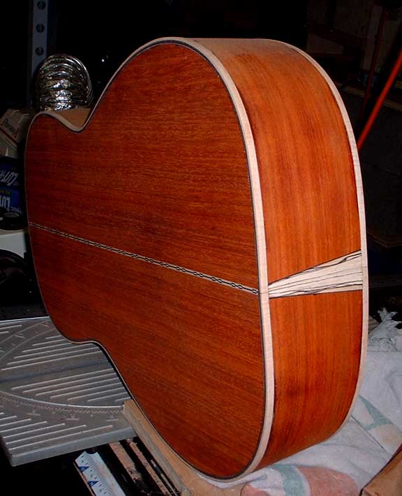

PostPosted: Sun Apr 09, 2006 2:54 am
Nice spalt in the graft. I have some maple and sycamore spalting that should be ready to cut soon. I'm hoping to catch the sycamore while it's still strong enough for back and sides.
PostPosted: Sun Apr 09, 2006 2:28 pm
That one is lovely Jeff !

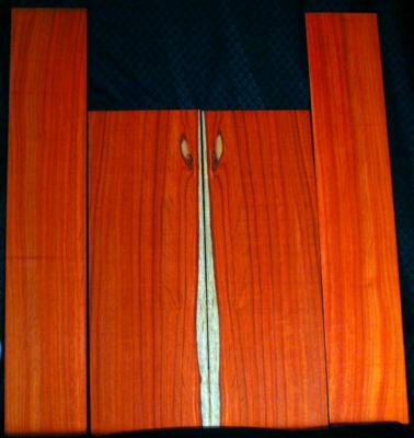

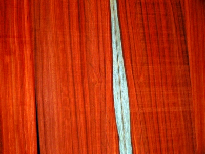

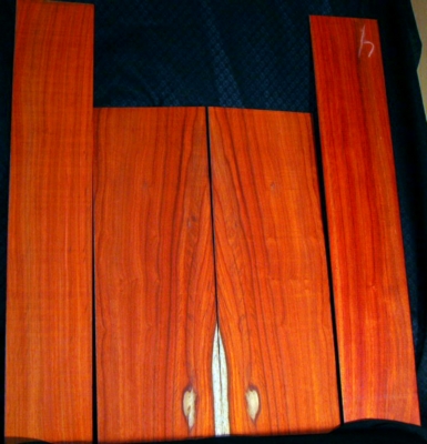

Posts: 697
Just got some Paduak boards in a couple days ago. Here's some pics of a couple of sets I've cut. I love the lines on these sets and the sapwood.
PostPosted: Sun Apr 09, 2006 10:20 pm
Whew hew Doug, i agree with you, some killer sets!

Posts: 1059
Doug, that back set of yours reminds me of the orange shaggy-haired monster in the old Warner Bros cartoons.

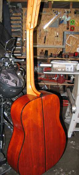

Posts: 785
My son built a Padauk guitar (he was 10 at the time), and it looks and plays great. Here's a picture:
The color is more red than this picture shows. He built it a year ago, and we have yet to see any of the darkening/browning that people complain about. It's still as bright red as the day he completed it. We'll see if that changes over the next few years.
Love the smell of the wood, but it makes your shop look like you dipped the whole thing in bright orange. It is very brittle, but we had no problem bending it to a dread shape at .80".
It sounded pretty good from the start, but it took about six months before the tone of the guitar really came alive. Now it is one of the best-sounding guitars to come out of my shop.
One final comment: It is a very BOLD color.
